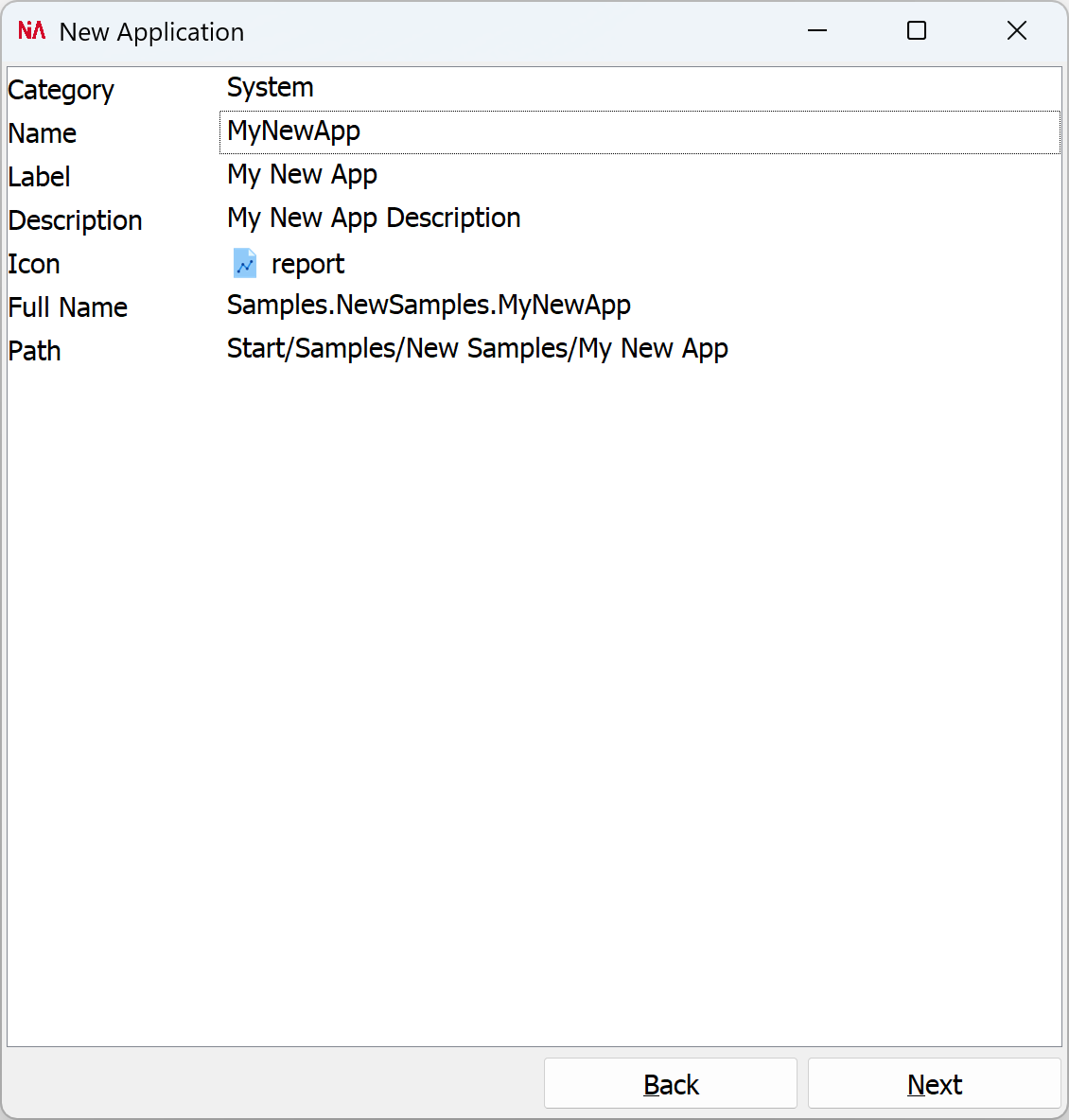

Name, Class and Icon
In the second page of the New Application wizard fill in the required fields like in the picture below and press the Next button. New Application->Second Page...
App Name must be an alphanumeric text without any spaces or special characters and must start with a letter. This name will be used in JavaScript code to identify application's class.
App Full Name is read only and is made of app's parent container name and this app name. This name will be used in JavaScript code to identify application's module.
You can see here how to use app name and full name to start an app from JavaScript code.

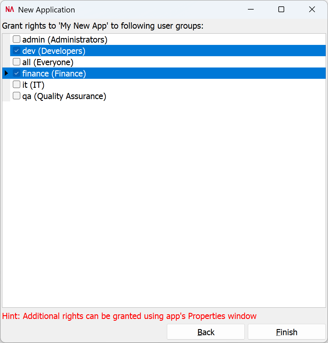

Security
In the third page of the New Application wizard select which user groups will have the 'execution' right on this app and press the Finish button. Application rights can be also later granted or revoked using app's Properites Window (command Properties... in the context menu in the first picture above).
New Application->Third Page...
