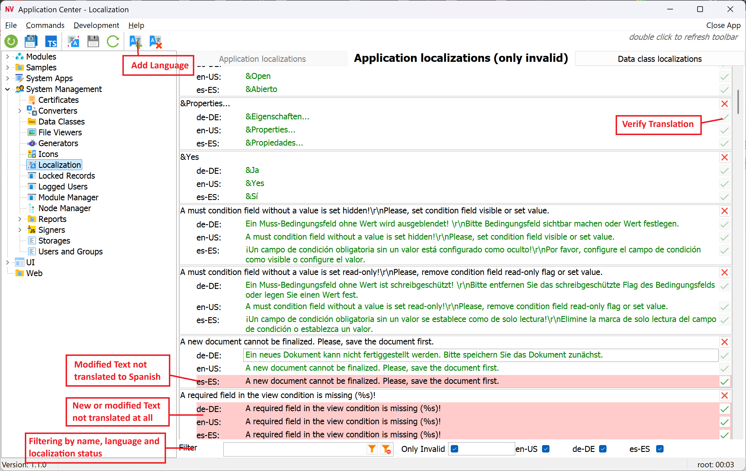

NodeActa simplifies system localization to the fullest extent. Localization is performed via system app System Management→Localization (see the picture below).
