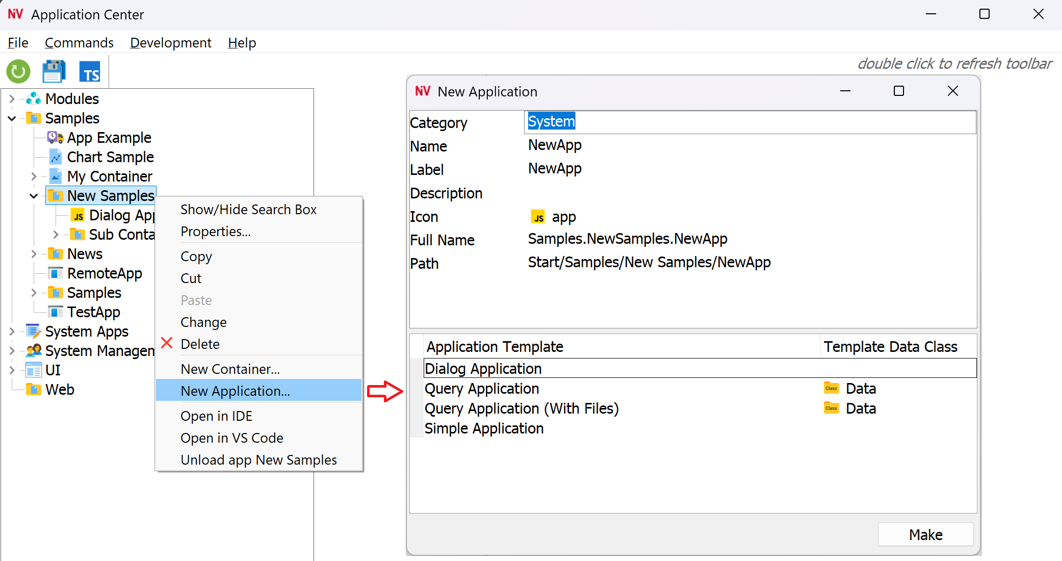

Launch New App Wizard
Select container (folder) where you want your app to be located. Then call command New Application... from the context menu like in the picture below.
Context Menu→New Application...
In the New Application wizard follow the instructions and fill in the required fields. Depending which application template you choose, different actions are required. For some examples check out our How To section.

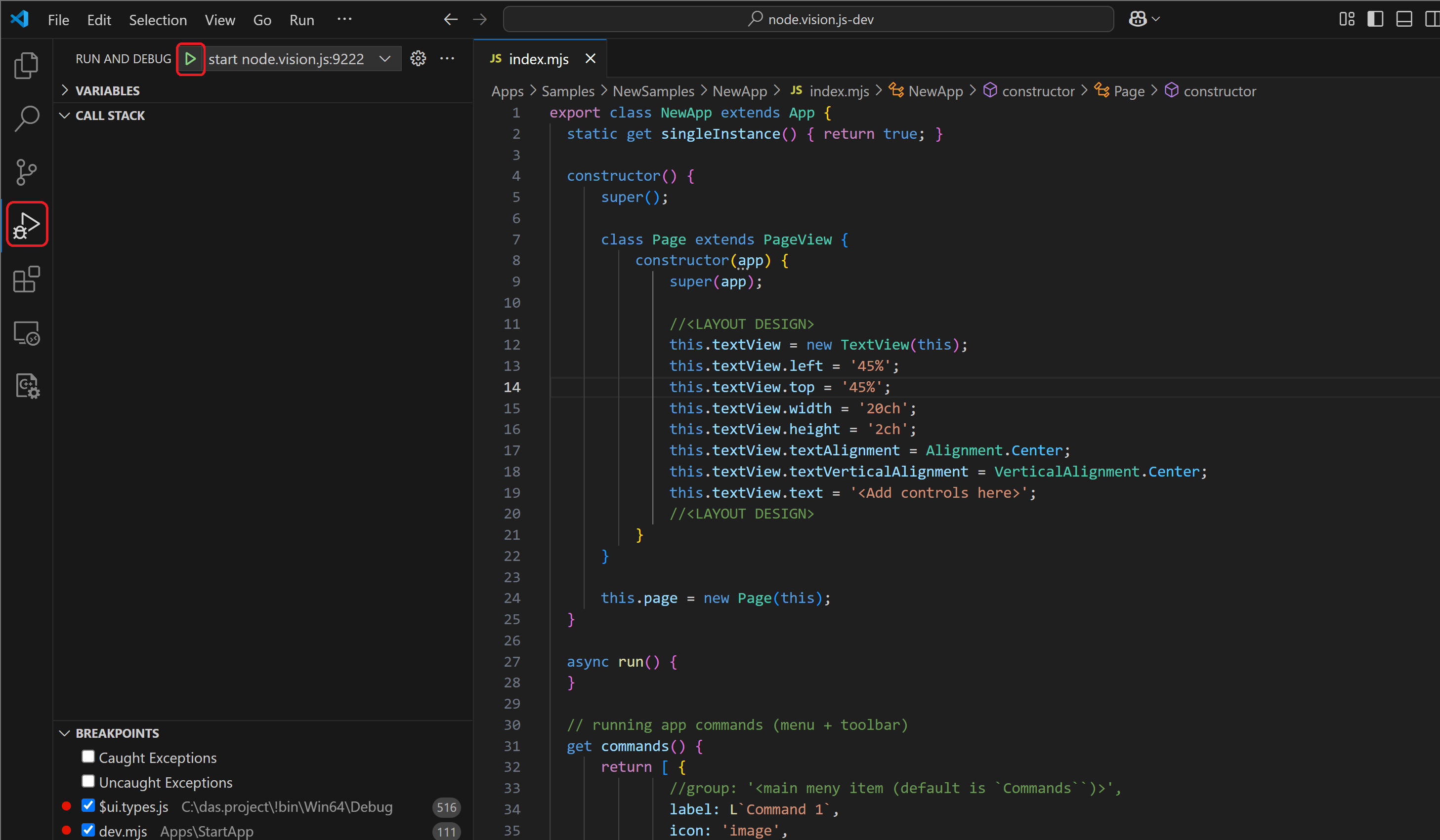

Debug Your Code
You can start debugging your code by pressing F5 in VS Code, or by switching to the Debugger tab and pressing the Debug button like in the picture below.
This will start Application Center and ask you to login. It is important to login within 15 seconds, od debugger will not be active. Start Debugger in VS Code

If you select Simple Application template when creating your app, the system will create the basic structure of a single page app like in the picture below.
Edit code in VS Code
Generated code includes the NewApp class definition, which must inherit from either the base App class or another application class. For instance, you could create a NewAppEx app that extends NewApp and overrides only the methods you wish to modify.
Within NewApp class constructor, a single Page with a single TextView is defined.
The TextView declaration is enclosed within //<LAYOUT DESIGN> markers. These markers indicate page layout boundaries and are utilized by the Page Layout Designer. Removing them will prevent you from designing the page layout using the Designer. Additionally, avoid making manual changes to this code, as it will be overwritten by the Designer.
In NodeActa, each application includes a run() method. Page layout should be designed within the app's constructor, while data initialization should be handled inside the run() method. Keep in mind that constructors cannot call and await asynchronous methods, whereas the run() method has no such restriction. See Launch App From Code.
